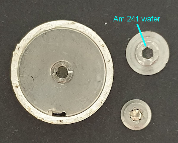

I just thought, do you have an old smoke detector laying about? The older ionizing type have a small Americium 241 pellet inside the chamber. If you could carefully extract the pellet that should give your sensor something to detect. Americium 241 is mainly an alpha emitter so your sensor won't pick up on that, however the decay chain products from the Americium decaying are a gamma emitter, so you will get some clicks from the gamma rays at a short distance. Here is an instructable on obtaining one: https://www.instructables.com/How-to-Obtain-and-Extract-Americium/
If you do try getting an Americium pellet, do be careful. Do wear appropriate PPE. If doing this for the first time then do some research into it. The pellet is a very small metal wafer with the Americium coated on one side. This wafer is then placed into the middle of the round housing piece that holds it and is pressed in by machine. Do not try and remove this, keep the whole pellet as one. Also keep out of the reach of children as it would be very easy to swallow. Handled and stored correctly low level radioactive sources are generally not an issue. And again, research before trying anything like this for the first time.
