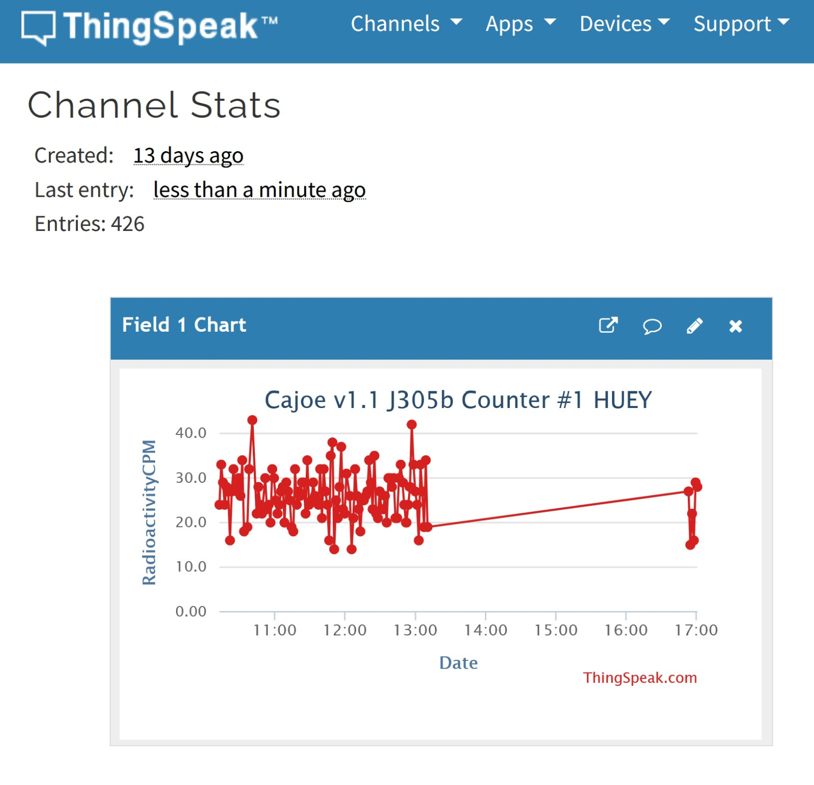

I have a problem with one ESP32 dropping the WiFi connection, it has done it twice within 24hrs. I'm not sure why as all 3 are within 6ft of a mesh node so even if their signal is fairly weak it should be good. They do tend to have poor antennas so I'm investigating how to improve WiFi performance on these things. I currently have all 3 counters connected to ThingSpeak just to monitor consistency. They need to be working well before I start uploading to Radmon.

which helps identify and indicate strength of the WiFi signals, it's fairly old but works fine. All three ESP32s are providing an acceptable signal so I'm not sure why one of them dropped the connection. It hasn't done it since so maybe there was something else involved. Not had any issue with the other two at all. I did have some patch wires crossing over close to the antenna but I've moved them out of the way now, that might have had something to do with it, There is also a way of adding an SMA socket to the board (after cutting the tracks to the PCB antenna) so I could use external antennas. The mod is simpe and I've ordered suitable sockets to do that but if it continues to behave then I won't bother.
