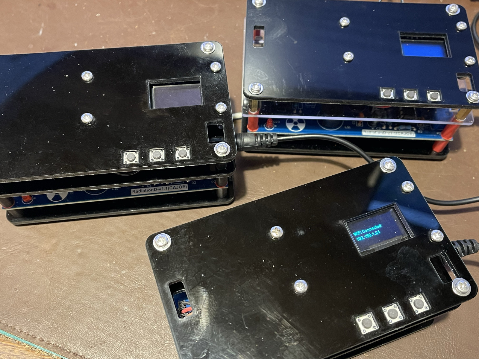

I need to check voltages on these Cajoe boards, I noticed current draw varied from ~150mA up to ~300mA between the three.

, I've been a model engineer for many years and have a capable workshop. I've actually added 3 interface buttons to the Cajoe/ESP32 cases now. The other two will likely be used for switching display screens but right now two of them are redundant. It was just easier to do it while I had them apart, just pop them in the laser cutter and it cuts out the little square holes for the switches.
