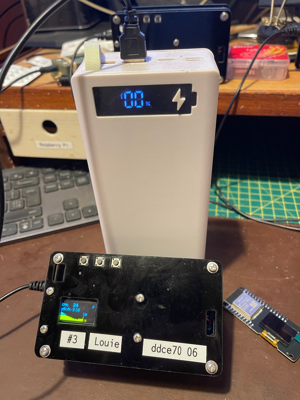

I was thinking... if you dump the internal battery could you fit an ESP32 into the battery compartment? Does it work without the battery installed?
Reason being in the past I bought a shed-load of faulty laptop batteries, from which I extracted all the good 18650s (usually only the odd failed cell which makes the entire battery faulty). So I ended up with hundreds of good 18650 cells which I tested and catagorised into sets. Then I bought a bunch of battery pack holders (they're cheap) and each one of those holds 16 x 18650 which I use to power projects long term. They are used to power Huey, Dewey and Louie. Now sure how long the power actually lasts but it should be a while. Anyway, I could also use one to power this counter via the USB-C charging port IF it will run without an internal battery..

Yeah, it works fine without the battery, although it makes a bit of a whining noise. Sounds like an inductor 'singing'. The other caveat is the battery is required for the clock, so without a battery when the USB is unplugged the date/time will revert to 00:00 01/01/2023. If using the internal data logging capability then this would be a pain, but if using ESPGeiger or similar then it is probably not an issue.

I believe I can charge the battery banks while still connected and powering a device, I need to check but if that's true there's no need to ever disconnect the counter. I'm hoping the power bank can power he counters for a couple of months or so before needing to be recharged.

No way am I going to get 2 months out of a battery bank, even big ones. I was thinking about the ESP32 but forgot about the 150-300mA the Cajoe boards eat up. So I found an old USB2 hub and with a 2A power supply can provide ~500mA on each port.

On my modified YGR01 (at 5V USB input and full battery) it consumes 29mA without BLE and the ESP8266. With BLE and the ESP8266 enabled it consumes ~108mA. When charging the battery you can add about 450-500mA on top, although this decreases when the battery is nearly full.
So with the ESP8266 enabled (and BLE, and assuming the battery is charged) it would consume 2.6A/day at 5V input and that translates to around 3.5A/day running at 3.7v (nominal LIPo). So if your batteries were 2.6Ah then you would need roughly 40 LIPo cells to run the YGR01 for 30 days. If you are pulling ~300mA (CAJOE + ESP) then you would need roughly 120 LIPo's to last 30 days.
Probably best to run on a PSU!
I have had some issues with cheap PSUs in the past causing noise on the counter - extra spurious counts and spikes, so if you can try and use one that is a fairly high quality, or better still and old linear power supply with proper transformer and linear regulator.
