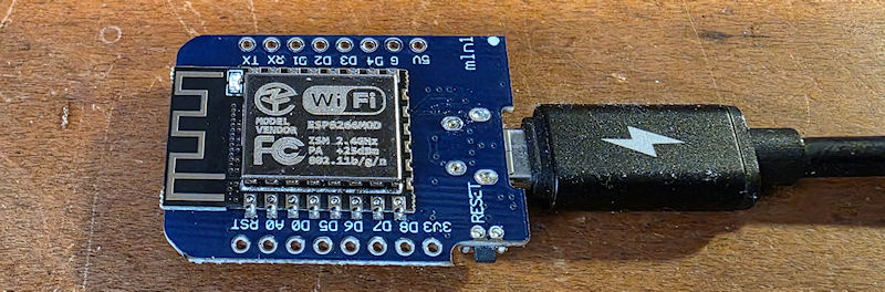

I wrote Grok wrote me a small Arduino sketch for receiving the CPM from an ESPGeiger and sending it to the serial port on a PC/server. This can be used to get the CPM from any ESPGeiger sending to a MQTT server, or modified for any counter using MQTT. It's just a case of change the details to suit your own WiFi/MQTT server etc and the topic, load onto a Wemos D1 Mini, or other flavour of ESP8266 (with serial connection), and plug it into whatever PC/server you are running Radlog Pro on. Set Radlog to use the com port of the Wemos and baud to 9600. The code sends the CPM to Radlog every 5 seconds, however the default in ESPGeiger firmware settings is 60 seconds. I changed ESPGeiger to send to MQTT every 5 seconds and this made Radlog a little livelier, and a higher resolution for HA too.
Here is the code. Change the settings to suit and upload on an ESP8266. Plug in and go.

Steadramon mentioned the method I was using (MQTT stat/* (stat/CPM) etc) are depreciated, so I have Grok has updated this to use the proper JSON method. New code (don't use the old code):
