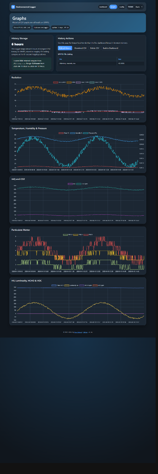

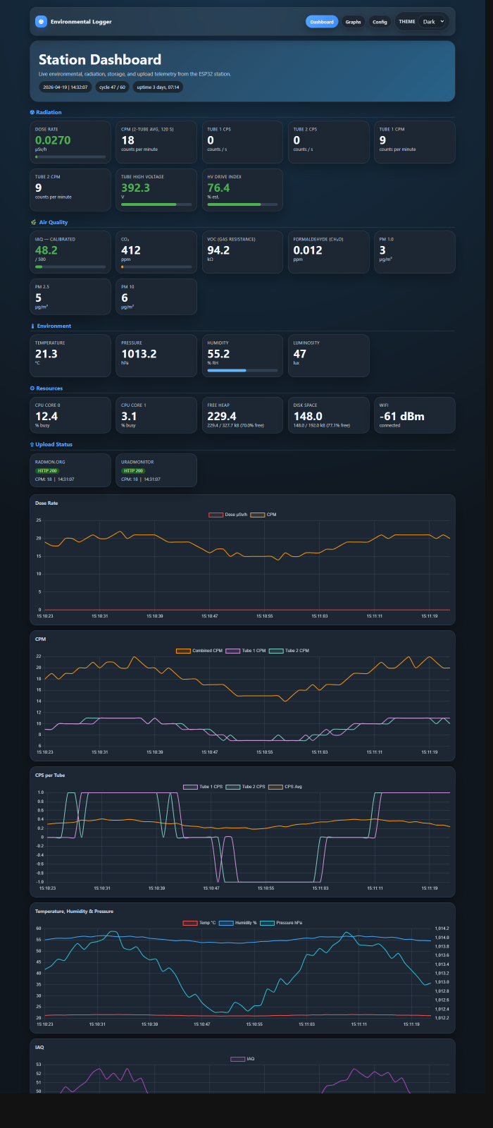

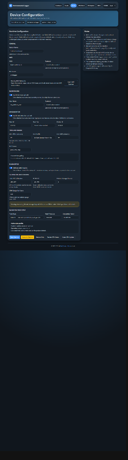

Hi all,It's been a while that I finally had some time to fully rework my ESP32 geiger counter setup at home., this include the hardware and software code for it. It's been a wild ride so far from a simple one page dashboard to a multipage dashboard with current readings, historic data, configuration options and OTA updates so I can place it wherever I want on my property.
A full write-up and code is to be found on my github page.https://github.com/DonZalmrol/Environmental-Logger-with-ESP32
Feel free to fork/copy the code for your own ESP32
It's a fully reworked version that was based on my existing moving average, tube conversion factors and deadtime. It's been a search to get the actual data for most tubes as many sites tend to provide slightly different versions.
With this data you can either add a custom tube for those not listed or select one for which I've found the data
Thinking about also publishing version solely for radmon for those only wanting to upload their radiation data.
