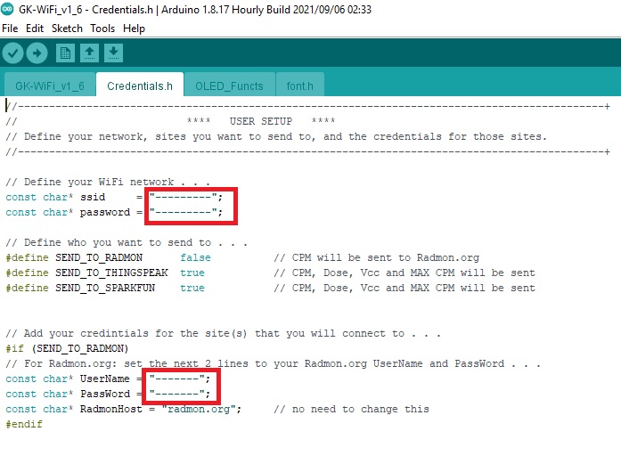

Ouch , that's going to be a challenge.
From reading the doc there is no web interface to configure the device.
Instead the info is hard coded in the software.
You will need to edit the file : credentials.h with all the required info needed to send data to the servers and your wifi credentials, and giger counter settings.
You could check if you can find a "credentials.h" file somewhere with the wifi settings you currently use already filled in. That would mean you have the source code that is already set up with your personal settings to start with. would make things easier.
Then compile everything.
Then upload the compiled software to the board.
Given the age of that software, that is not going to be a 1 shot process.
highly likely you will run in to issues with old libraries, drivers , and IDE. that will need to be addressed. (maybe use an old version of the arduino ide)
And if it fails to connect or upload to the board it's going to be all but impossible for anyone not having the same setup to help with that step.

Hmmmm my GK WiFi board is totally the same like this one here:
https://sites.google.com/site/diygeigercounter/networkkit
At the bottom of the page is written: "The Build Instructions for the current v1.5 board with v2.0 software are here." And the files from the hyperlink are these:
https://drive.google.com/drive/folders/1tnz2gONcVUhwagSvIU7VtlaZBXMnuSv6?usp=drive_link
In the main folder is software v2.0. In the folder "Previous Versions," you'll find v1.6 and v1.7. So, I guess one of these SW versions is for my Wi-Fi board (which, as I said, is pretty the same as the one from the link above). Now the question is how to know which one is my version? All of them have a Credentials tab when open in Arduino, so does that mean I could use any of them, since they were made for the same board? And as I said, I'm not an engineer, I'm a physician, so better to ask - I should use FTDI-USB adapter to load the sketch with credentials changed to my WiFi board, correct? Should I leave the quotation mark or delete it when entering new credentials? Sorry, too many questions, but I got a bit excited when I found that folder

Version 2.0 is what i would go for.
Yes according to the instructions you have to use the FTDI-USB adaptor .
But first you need to compile the configured software.
Leave the quotation marks around the strings, otherwise you will get errors.
I would try compiling without uploading first to see if that works.
next is trying to upload the compiled software.
